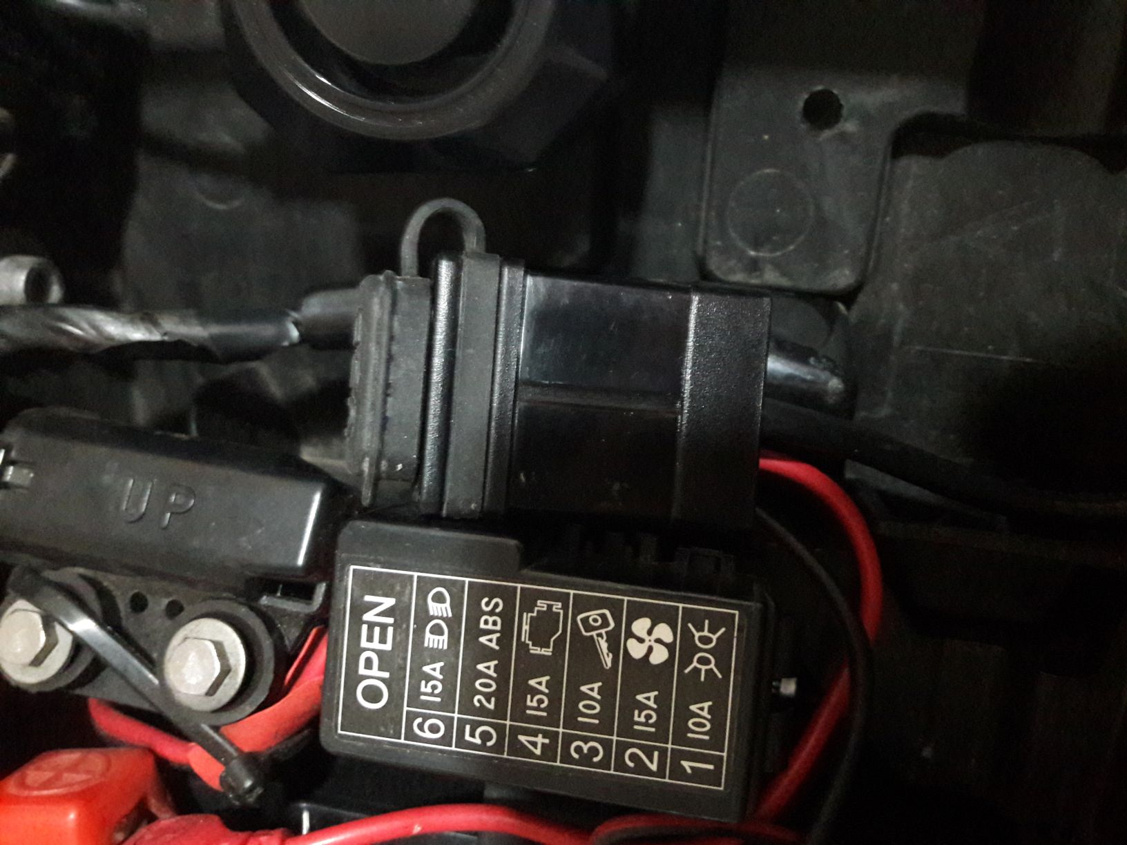

    I think I could get myself on the twat of the week with this one. While trying to test an idea with the cold start I fitted a lead acid battery with multiple terminals, rather stupidly put the battery in the wrong way round and crossed the terminals, luckily I have an inline fuse in place from the regulator to the battery and blew that.
    Couldn't understand why when running at idle it was reading 13 volts and not moving, changed the fuse and back up to 14 volts it went, so note to self, pay attention to which way round you fit the battery, bike is now tucked up in the garage, I've done years of riding in all weather and I hated it so I won't be pulling the Daytona out unless its extra sunny, but I have a few things I want to change while its off the road for a bit.

  6. You're not the first, I've seen it a few times on other forums, don't know if you've added an extra fuse but it normally just blows the main fuse near the starter relay, usually everything else survives the momentary reverse polarity.

    Yeah, the bike fired up straight away with the replacement fuse so I know I didn't blow the main one, but I'll be sure to check it when I pull the tank off and change the spark plugs for nice fresh ones

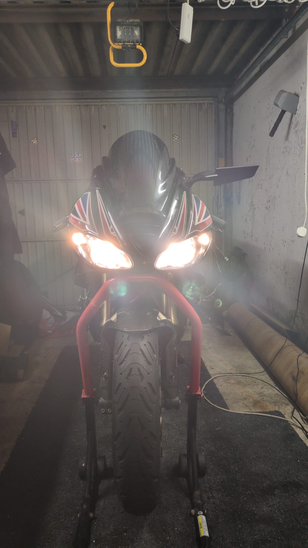

  11. Fitted these LED headlight bulbs, used to have Xenon HID in the dipped beam which were fine and passed the mot but when it failed went to a supposedly "whiter" halogen bulbs, Osram cool blue, but they were still too yellow and old fashioned looking next to the LED centre light.
    After some research chose these Philips Ultinon Access, very white and very bright as you'd expect, hopefully the beam pattern is close enough.

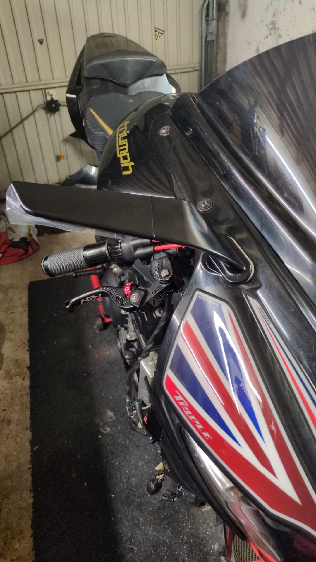

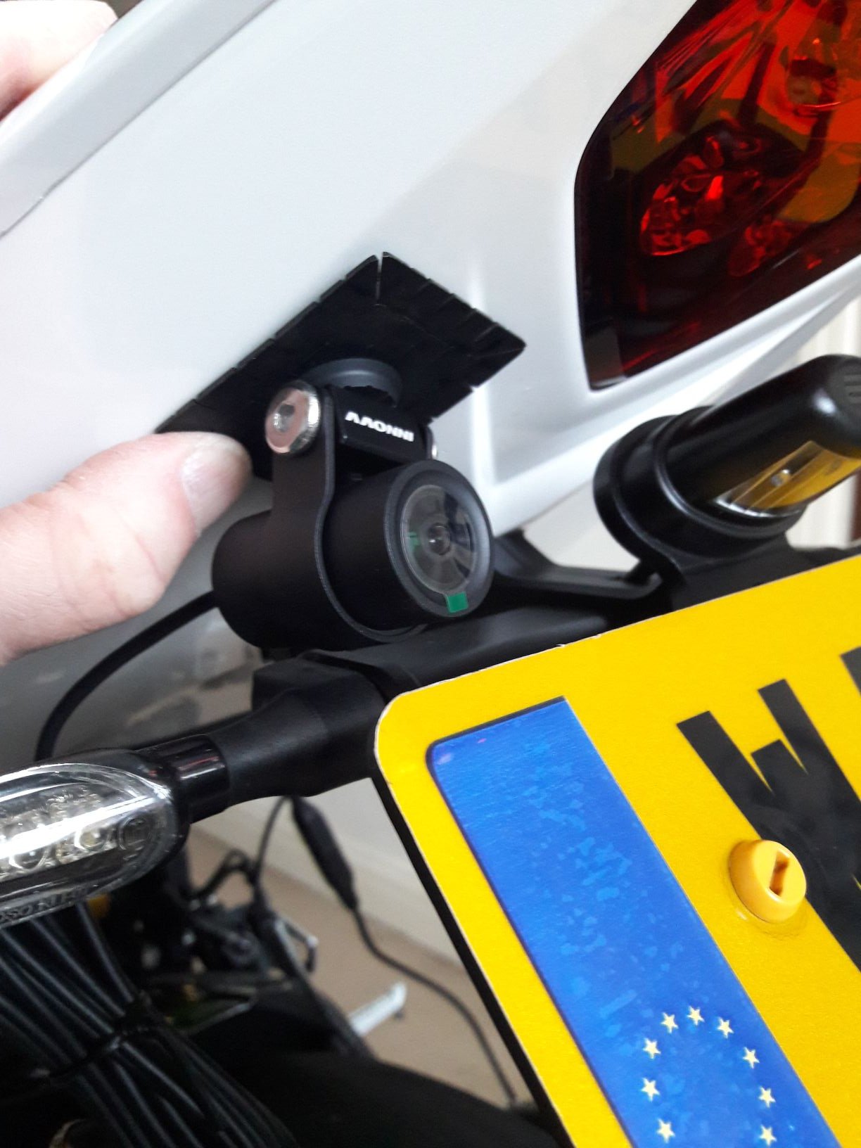

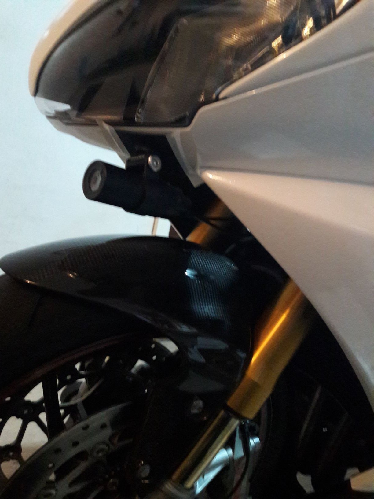

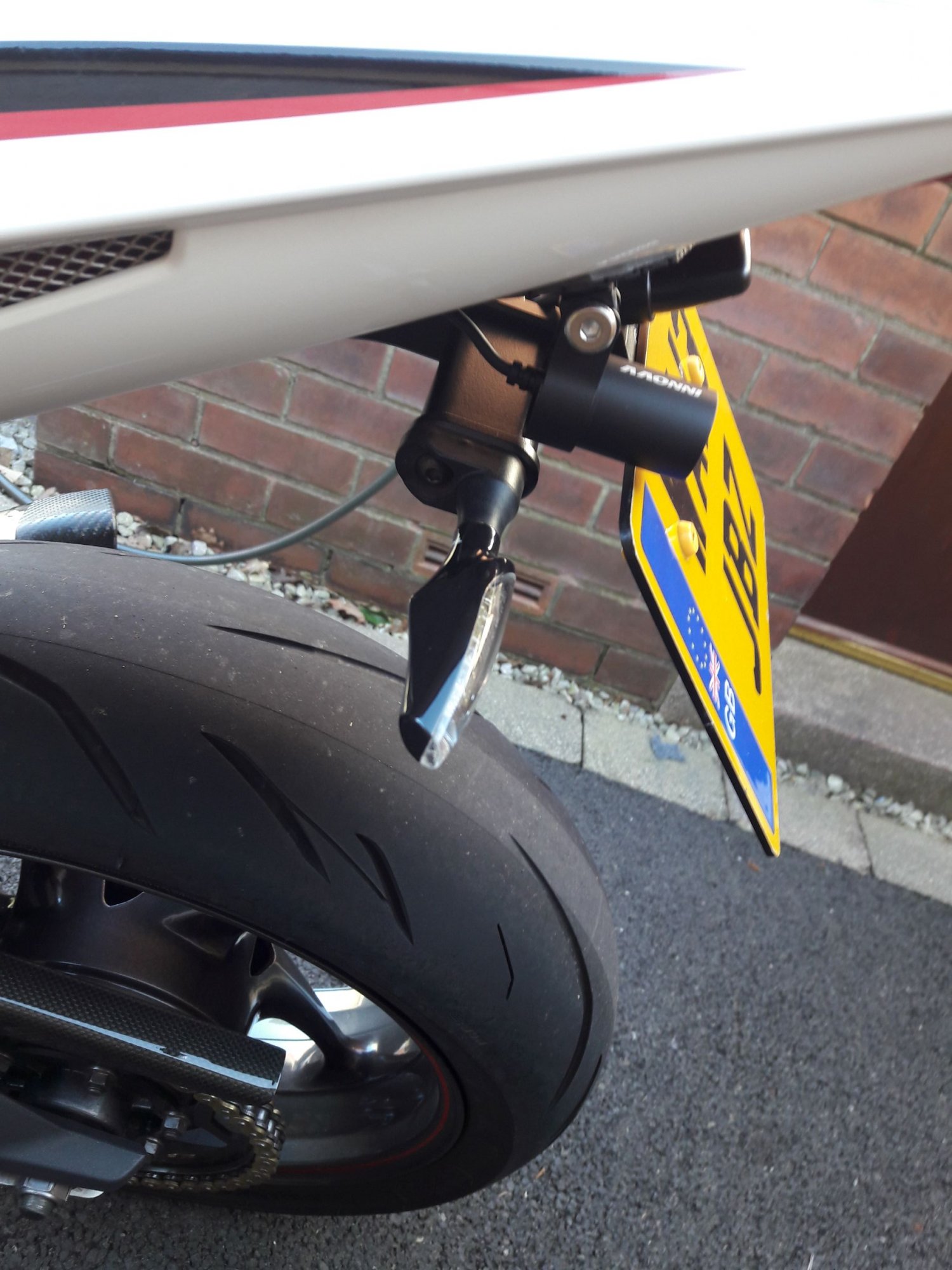

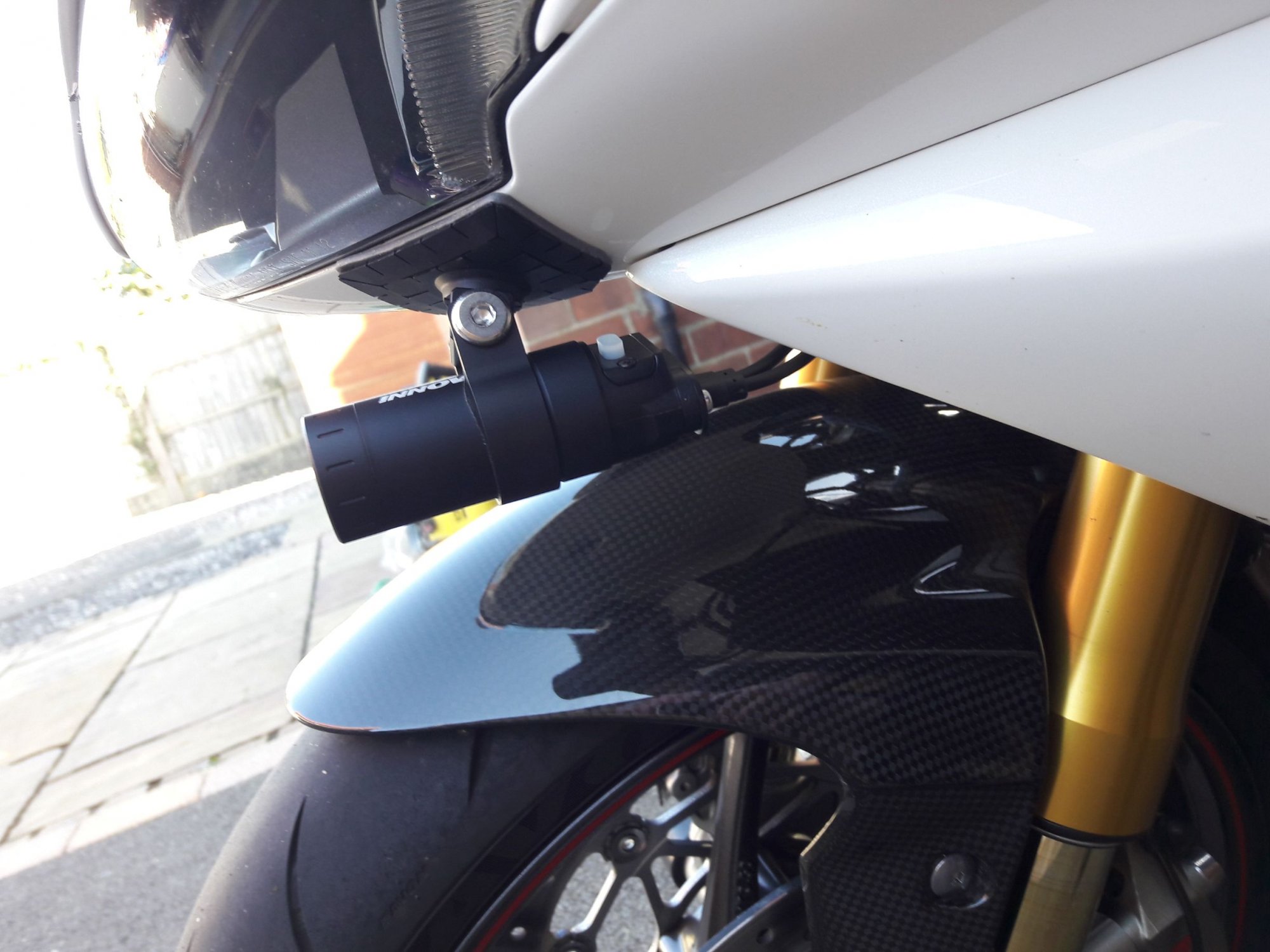

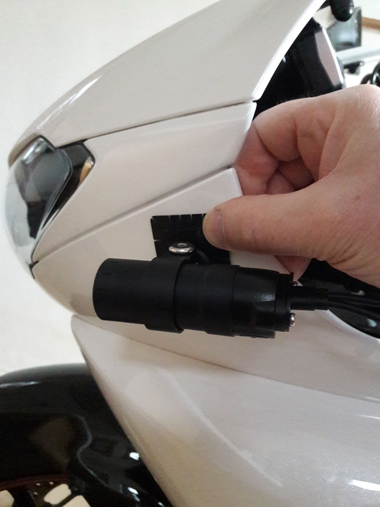

    After the accident last year which finished off the Thruxton, decided to fit "dashcams" to my bikes, even though everything turned out ok with the liability and insurance claim I know it could have been different in other circumstances and having some evidence to back me up could be a good idea.
    Purchased an Innovv K6 dual camera system to fit to the Daytona, wanted something with minimal wiring and wasn't bothered about a screen.
    Connected my USB socket I'd saved off the old Thruxton to use as the power supply, much less wiring than using the power supply module that comes in the kit, cameras can run off either.
    Not easy to find somewhere for the cameras on a sleek minimalist sportsbike like the Daytona, be easy on something like a GS with bars everywhere, just mocking them up for now.
    Was hoping to fit the front camera under the fairing nose but nowhere near enough clearance for the front wheel movement.
    This is the best position for the front camera I can think of, not ideal being on one side, does look really big in the picture close up but will be out of view with the bike parked. The rear will just fit under the tailpiece and clear the numberplate, will have to remove a bit from the mount to get the angle correct.
    Anybody have these cameras on a Daytona or have better placement ideas.
  12. StMarks
    13,245
    1,003
    I don't have a bike dashcam, but I do have a GoPro that I use for reviewing my track riding.
    On my track fairings I have numerous mount placements that I can clip the camera to depending on what I'm wanting from the footage.
    The most discreet placement is on the inside of the screen, looking through it at the road ahead. I did expect that it may obscure my view at times, but that has never actually been any issue.
    When it's installed there it's pleasingly innocuous, however when riding in very heavy rain at speed, the rain trails over the faring screen obscure the footage. Probably not an issue for normal road riding.
    Would the rear camera not have anywhere to mount on your tail-tidy ? perhaps alongside the numberplate light.

  15. Just tried on top of the indicator stalk but not enough clearance above, plus only half of the mount would be stuck on.
    Had another look at the front though and found an option just below the headlight that just about gives enough clearance for the wheel travel, plus would make the cable entry easier, the side option would probably mean notching out the carbon infill which I wasn't keen on.
