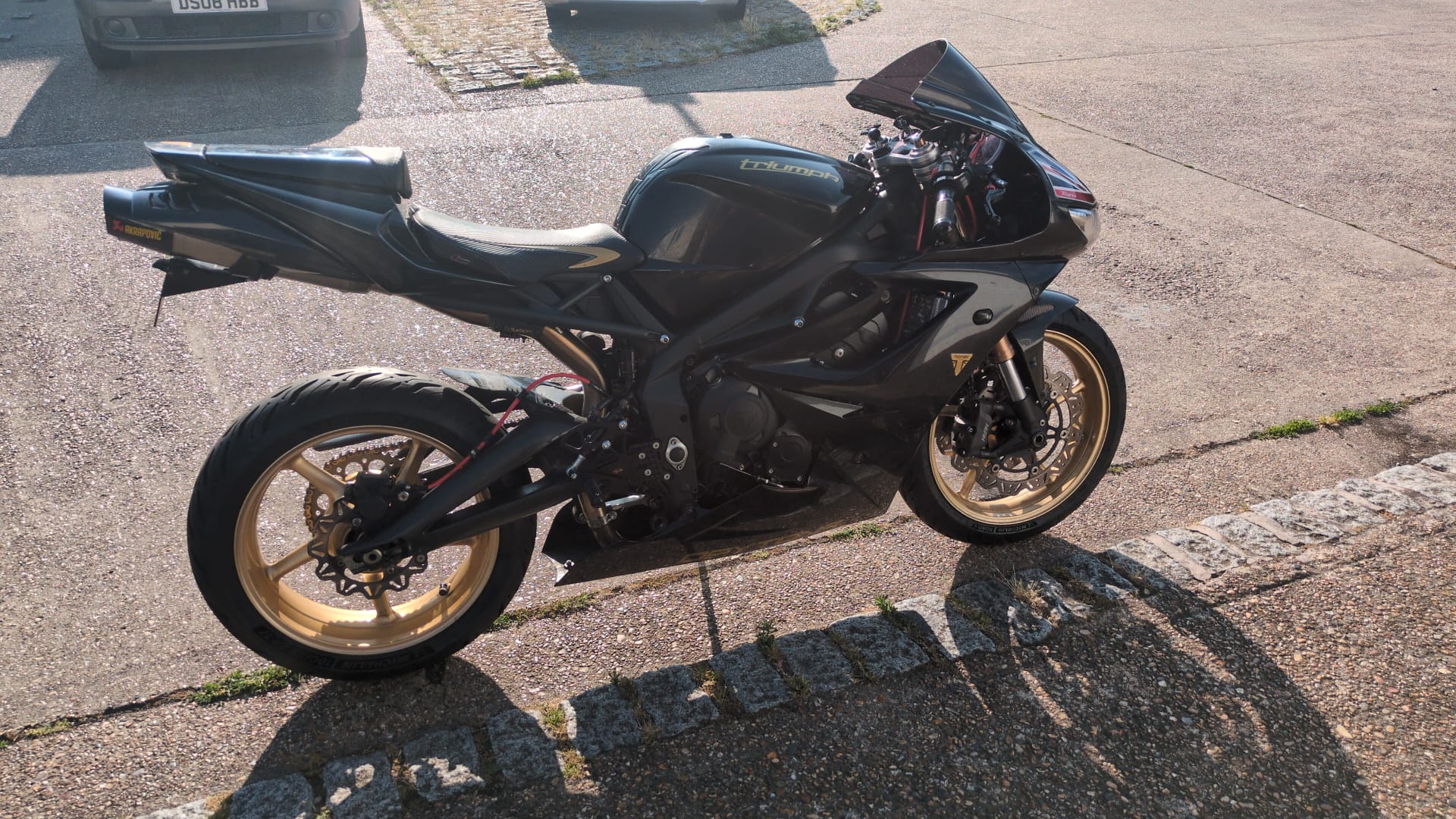

    And here he is, back home with me. A Daytona 765
    Need to just tidy up the headlight wiring because of the angel eyes etc but hopefully get out to test him soon before I take him to Wales[​IMG]

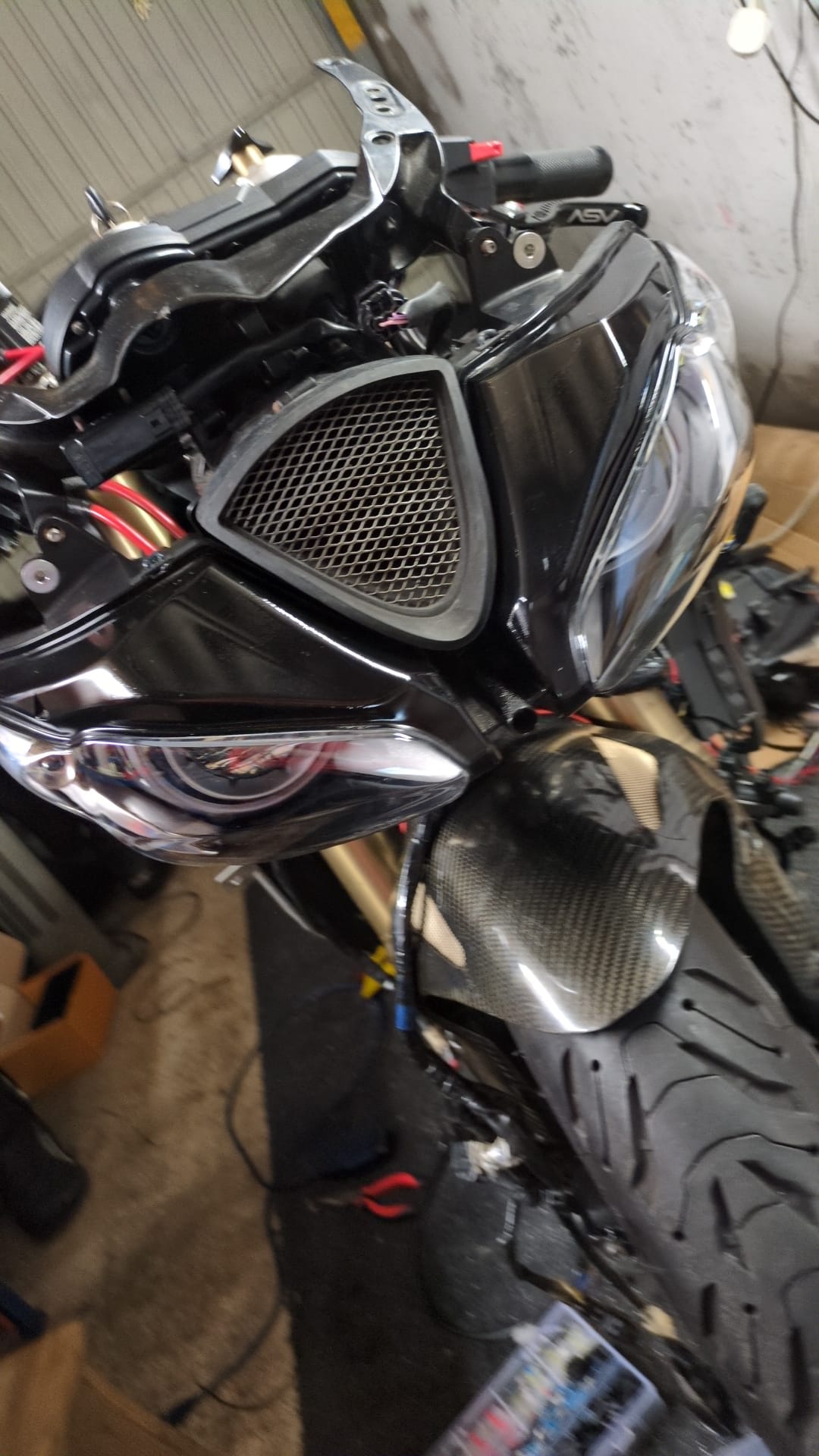

    After contacting KTMoto to get a wiring diagram on the headlights I've just about given up on fitting them. So I'll be switching back to a standard OEM set. No doubt once I fit the standard ones I'll hear back about the wiring
    I did however remove the triumph levers which I've had on the bike for its entire life and replaced them with ASVs, had them on a previous 675 and they instantly feel so much better and with tons more adjustment[​IMG][​IMG][​IMG][​IMG]

    Finally putting things onto the bike instead of taking them off. New OEM lights went on, felt nice not dealing with all that wiring.
    Also need to do a bit of DIY to the lower left bracket for the fairing. Due to the change in engine casing shape it doesn't quite fit perfectly, so I'm going to file it down a bit. It's not load bearing so I can take a bit off

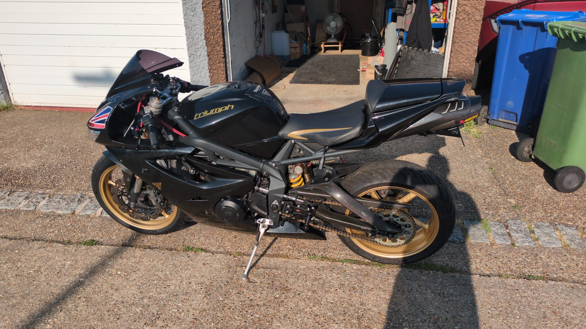

    And here he is, all dressed and ready for Sunday, taking him out early because like hell am I riding in the heat. It's been nearly 9 months since I've ridden him, this should be fun
