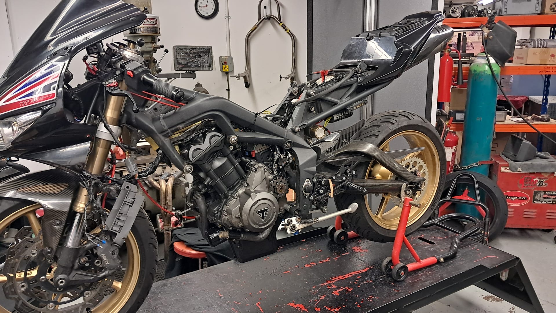

  1. Nik
    Nik
    335
    110
    Location: Holland

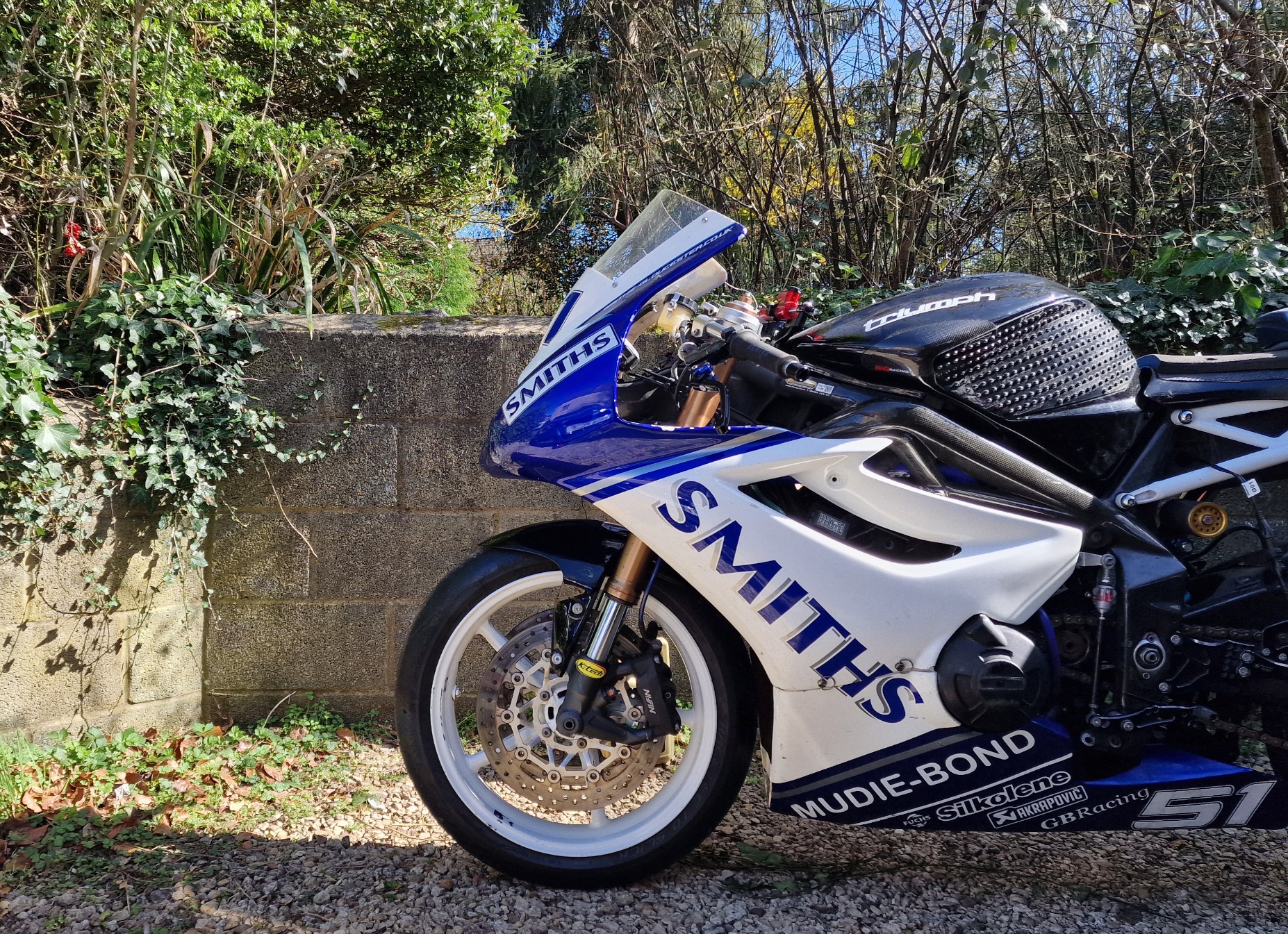

    Brilliant,any idea when you’ll be firing her up??
    How did you upload the pic??When I try the file is always to big.
  2. StephenP
    2,172
    375
    I just uploaded on the laptop, it is a WhatsApp picture so the file size isn't that big after it's been compressed
    And no idea on firing him up yet. Needs new hoses then it's wire everything back up

    110
    Location: Holland
    Thanks for the tip Stephen,as you can probably tell I’m still very analogue.I’ll have my fingers crossed for you,let us know how things progress.

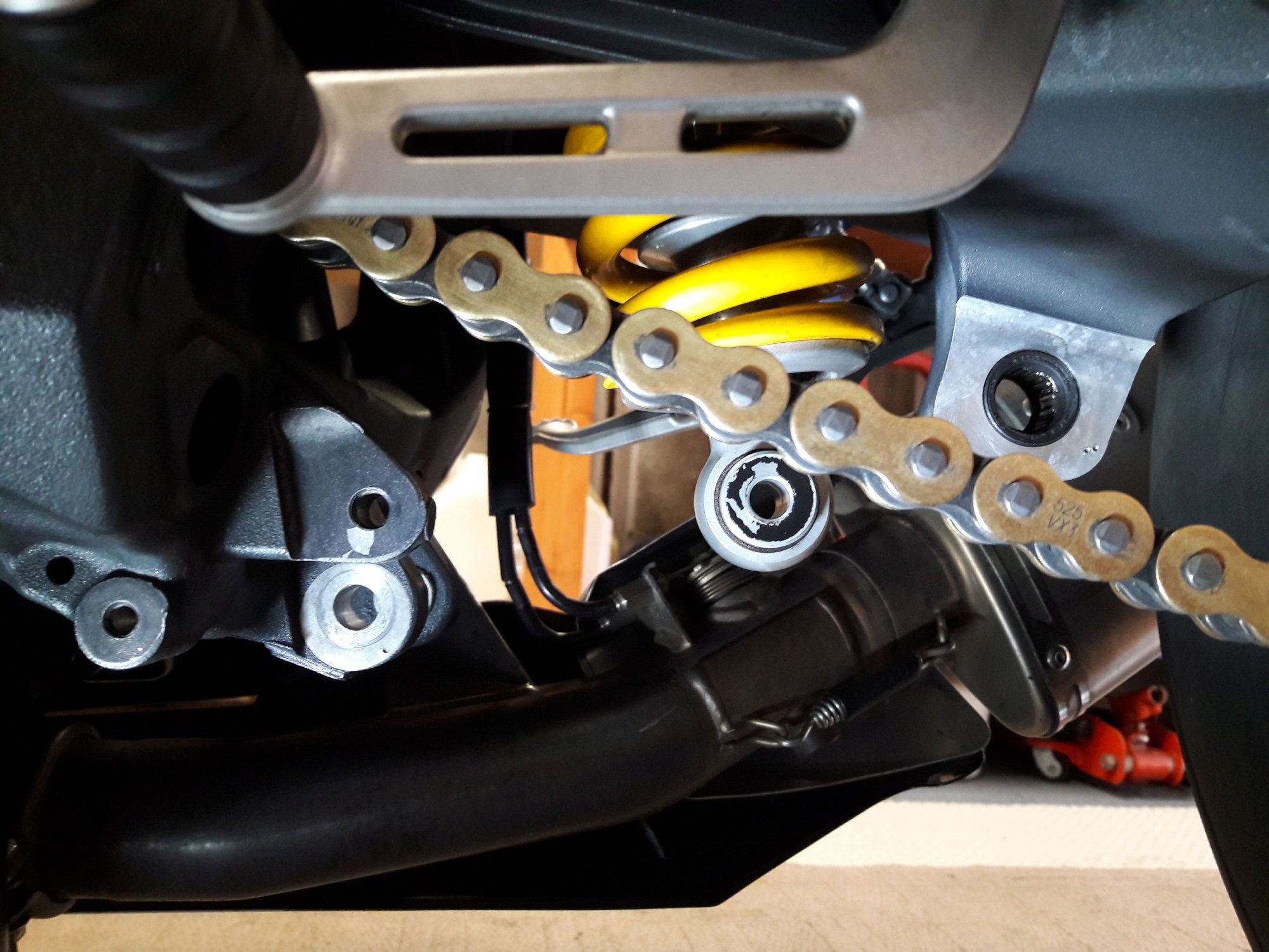

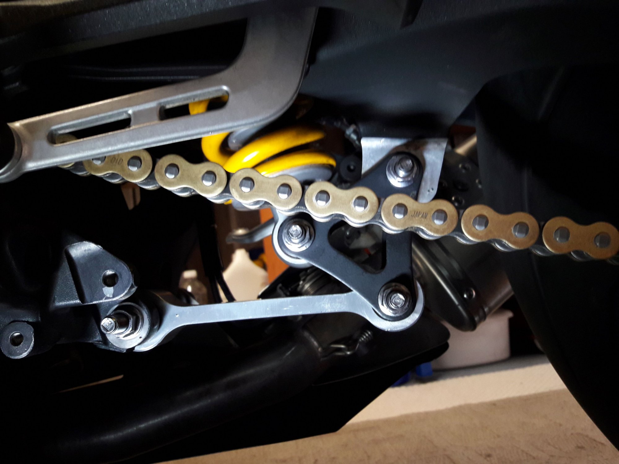

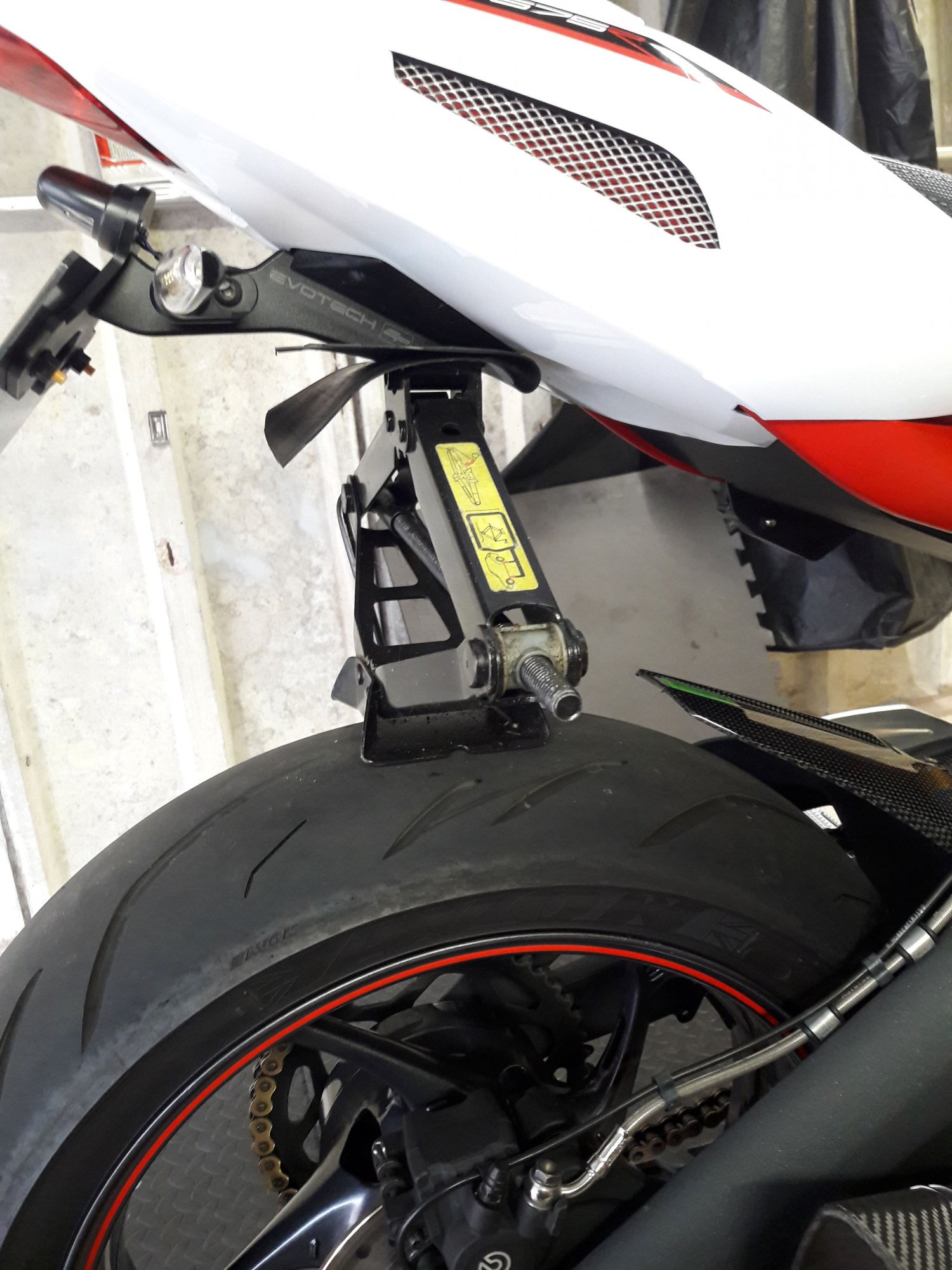

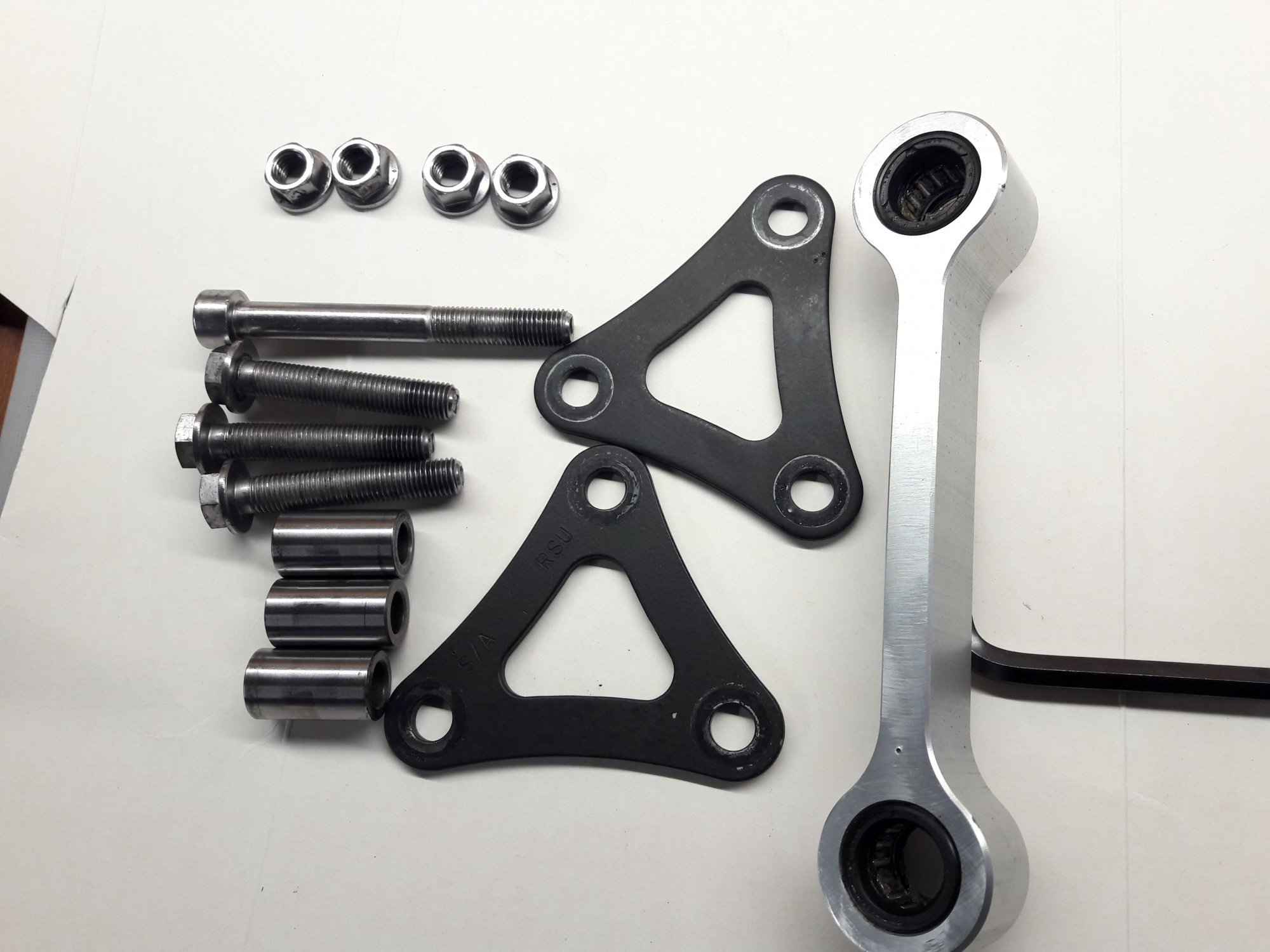

  11. Checked, cleaned & greased the rear linkage, was going to be part of the service later this year but had a spare hour and the weather was miserable.
    By far the easiest and safest way to support the rear, seen people on other forums strapping the bike to planks balanced across two stepladders and all sorts of other heath robinson ideas, crazy.:confused:
    Evotech tail tidy provides a very convenient horizontal surface and wheel was locked, did tie wrap the jack to the wheel last time but didn't feel it necessary.

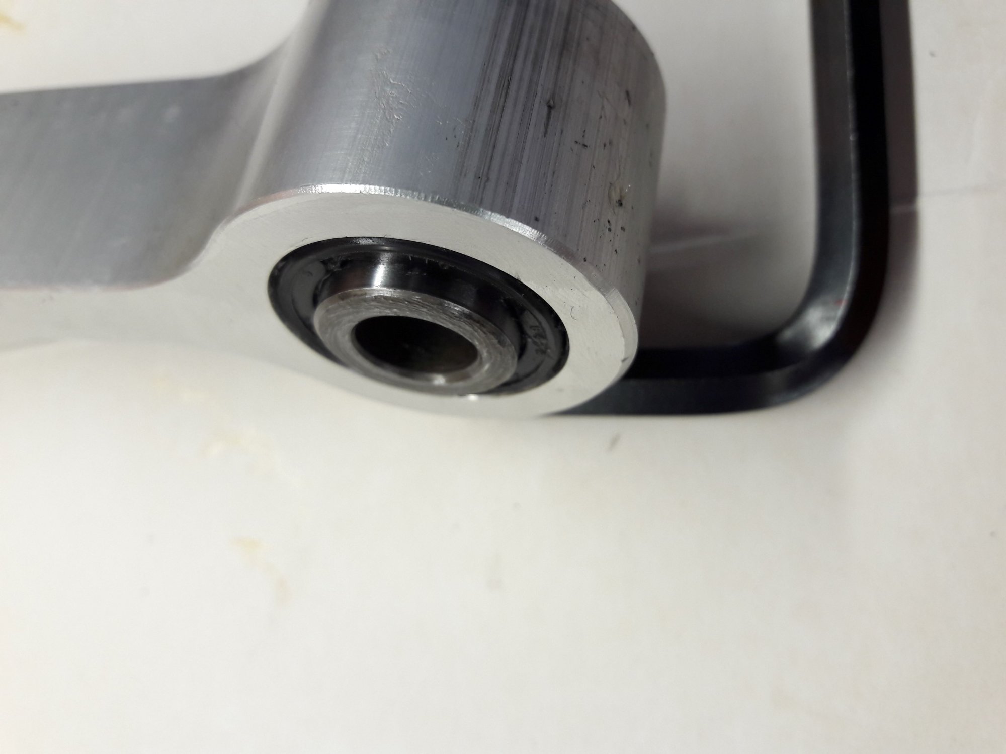

    Fitted new bearings and seals 5 yrs ago but only 6k mainly dry miles since so predictably everything was in great condition.
    just wiped the seals clean and ensured the bearings were still well packed with grease.
    Cleaned off any grease outside of the seals, only attracts grit and damages the seals.
    All back and torqued to 48nm, nuts still had very strong self locking action so didn't feel any need to replace them, plus they hadn't moved from 5 years ago.
    I would rate it as one of the easiest service jobs and you'd be daft to pay someone else to do it, only slightly trickier if you have to replace the bearings and press new ones in.

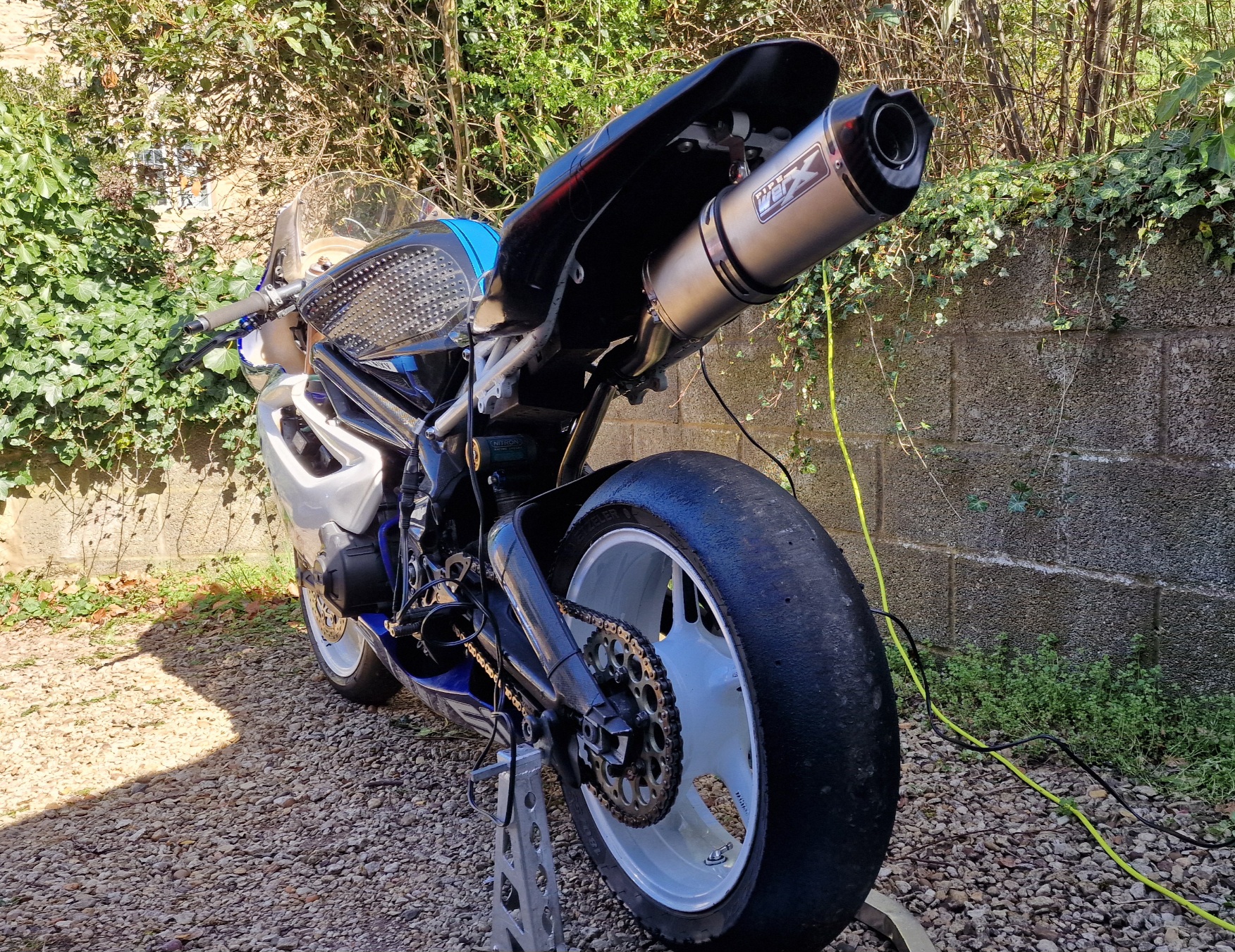

    Installed a canon on the track bike to ensure I comfortably pass noise testing.
    Way longer than my beautiful Ti Akra, which unfortunately blows 102 db with inner and exit baffles. Don't need the stress of trying to get it quieter in a panic.
    Front looks nice at least
