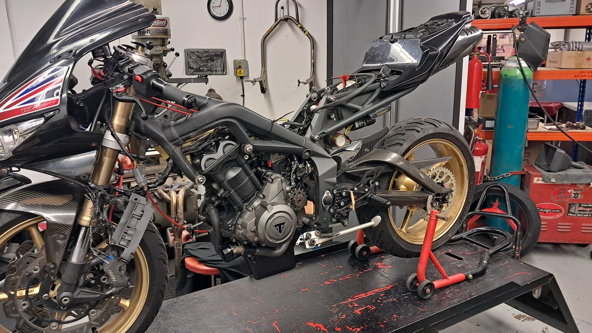

  20. StephenP
    2,172
    375
    Well..... we have a 765 engine in the frame.
