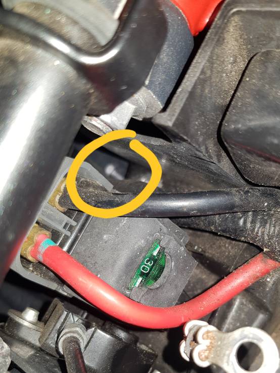

    Of course nothing goes smoothly the bloody bolt for the battery fell into the depths of the Daytona. 20190419_192520.jpeg
  7. You might be able to recover the battery but they don't tend to like being trickle charged, they need to be discharge and recharged, a decent tender does but a battery through different cycles, worth spending a bit more on a decent tender.
    Glad you got it sorted though, magnet on a stick to get the bolt out one of the best things I've bought from a £1 shop!
