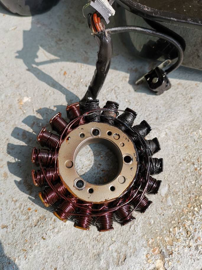

    400
    Ouch, that looks a bit fried
  2. Bigmac
    Bigmac
    5,072
    301
    Location: Slough
    Properly cooked that mate
  3. oh man!!!!!!!!!!! I'm glad finally found out the problem, stay out of the "made in china" stators (if you are looking on ebay) find someone who´s really good at rebuilding it or if you have the money buy an original.
    don't forget to check the rest of the wiring harness for more damage!!

    I was lucky enough to get one from @bignose from the forum.... it looks good so I will get that on her as soon as I get a chance and see how she runs....
  5. don't forget to check some other burned wires maybe that's the main issue burning the stator!!
