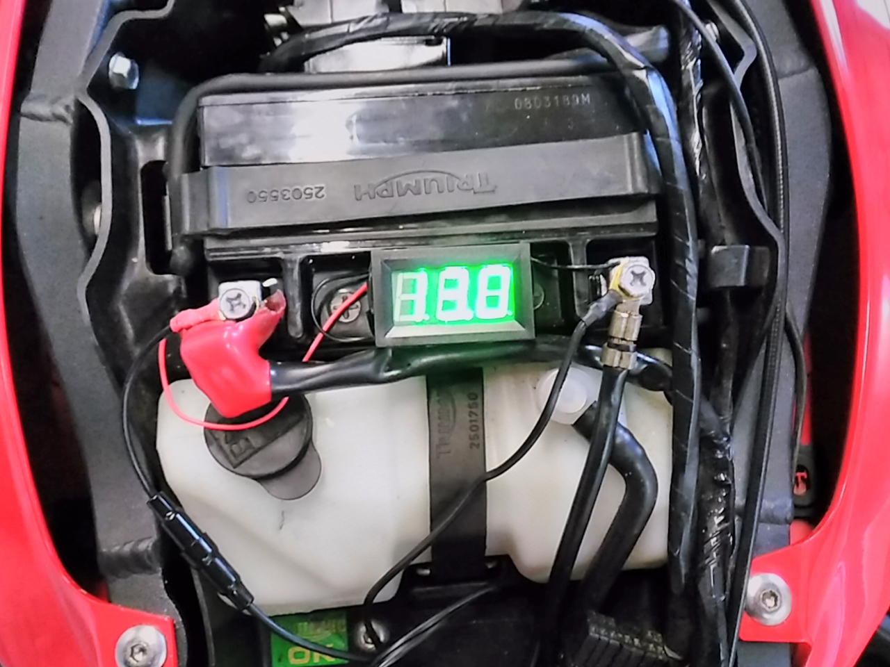

  18. T_daytona675
    I've got a R/R for sale if you do need one, been on my bike for years before triumph started recalling them but is the updated one that they started putting on them when recalls started £55 with postage
  19. I had a similar experience involving the stator and the regulator, turns out that the A/C wires coming out the stator and going into the regulator shorted on that end, as a result, the regulator blewup, the stator burned and i had to change the whole electric sistem (luckly I found am awesome deal on E-bay for a wire harnes ... the stator was rebuilt by my local mechanic. give that a try, maybe some wires got burned.
  20. Jay311275
    Jay311275
    1,039
    33
    Location: Staines
