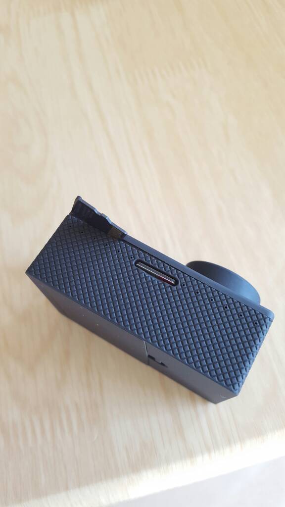

    Location: GB
    Yea its now consistently producing corrupt files. Other card is a old samsung 16gb. Another thing to add to my frustration is this.. auploads.tapatalk_cdn.com_20160504_89f6430f48deb734c44a1271bf5678d8.jpg auploads.tapatalk_cdn.com_20160504_1c1f21f16c3b84ab0c8040c41c0feaf1.jpg . Im going to ask for a replacement
