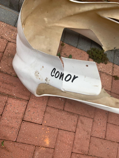

    I’ve got a fairing kit that is good condition (only used once once or twice) but in need of a small repair

    Happened in transit when I got them from a friend. I see you are from Stourbridge, I could get them delivered taken to kiddy if you want them

    Easy little bit of fibreglass repair, and those ^ look like they'd be a perfect start for you. :D:D
