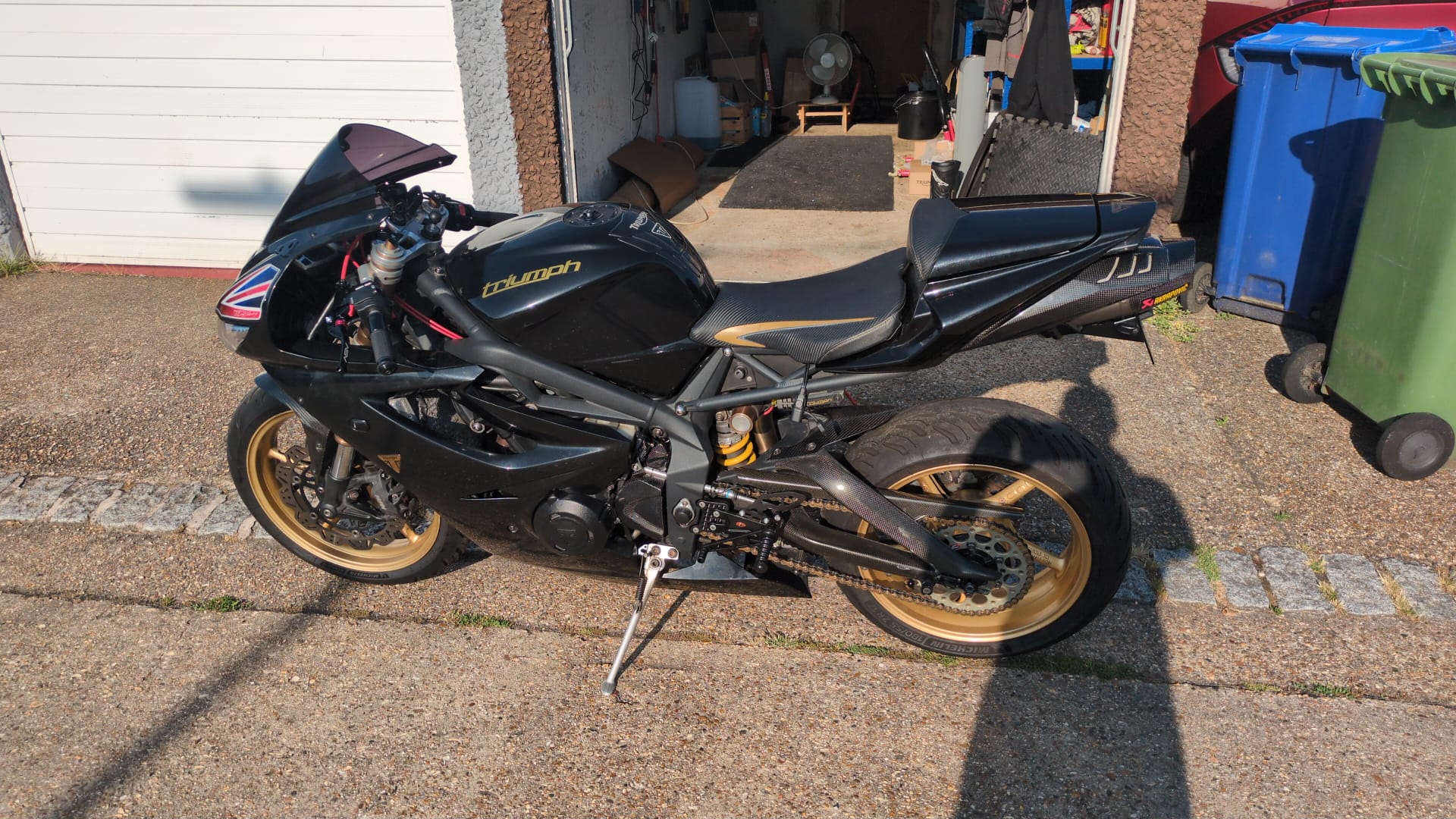

    This was the bike shortly after the new engine was fitted, as you can sit it bolts straight in, the sump was modified and changed so that the exhaust could continue its route down the right hand side and I'd get to keep the undertail exhaust

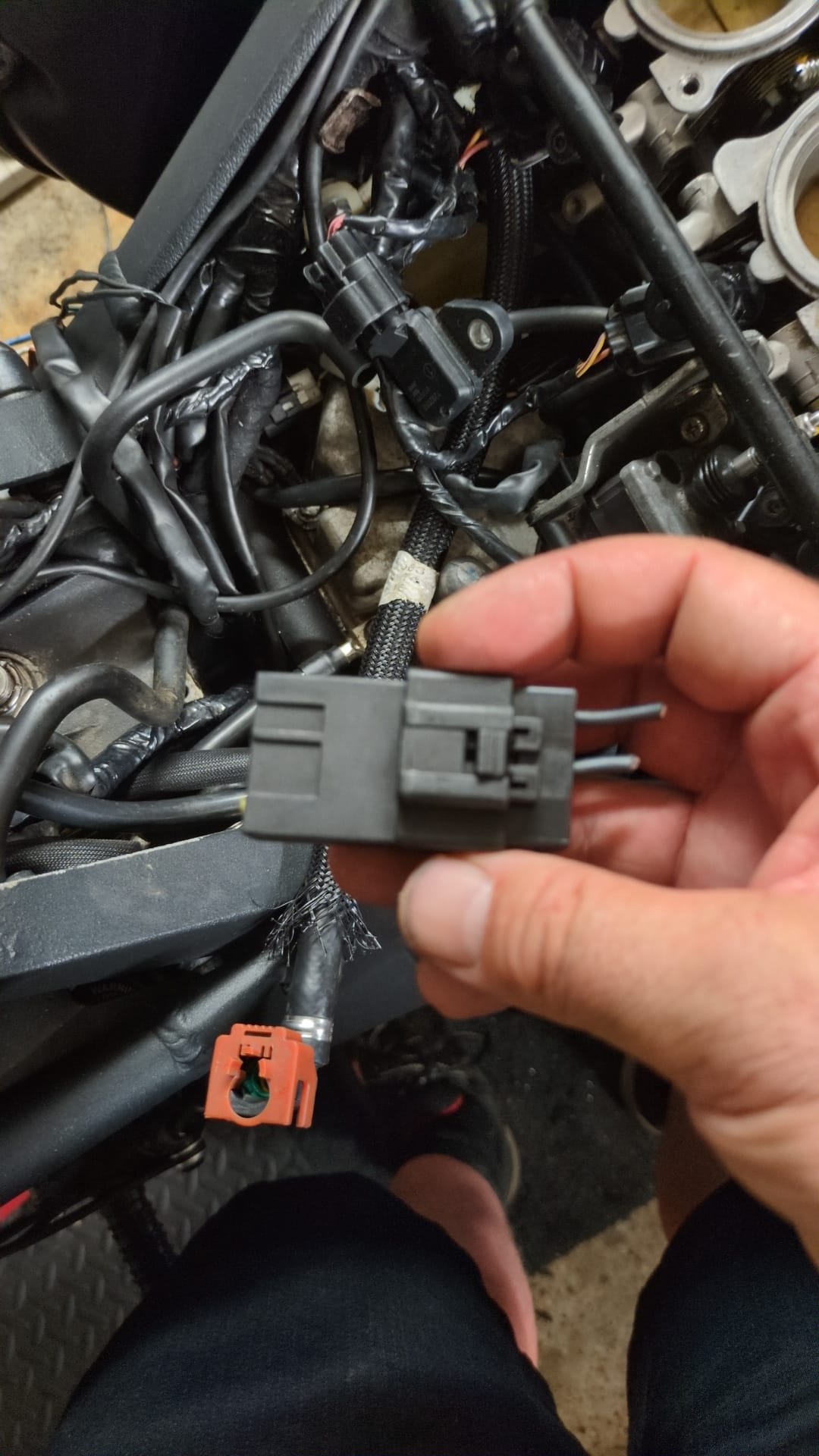

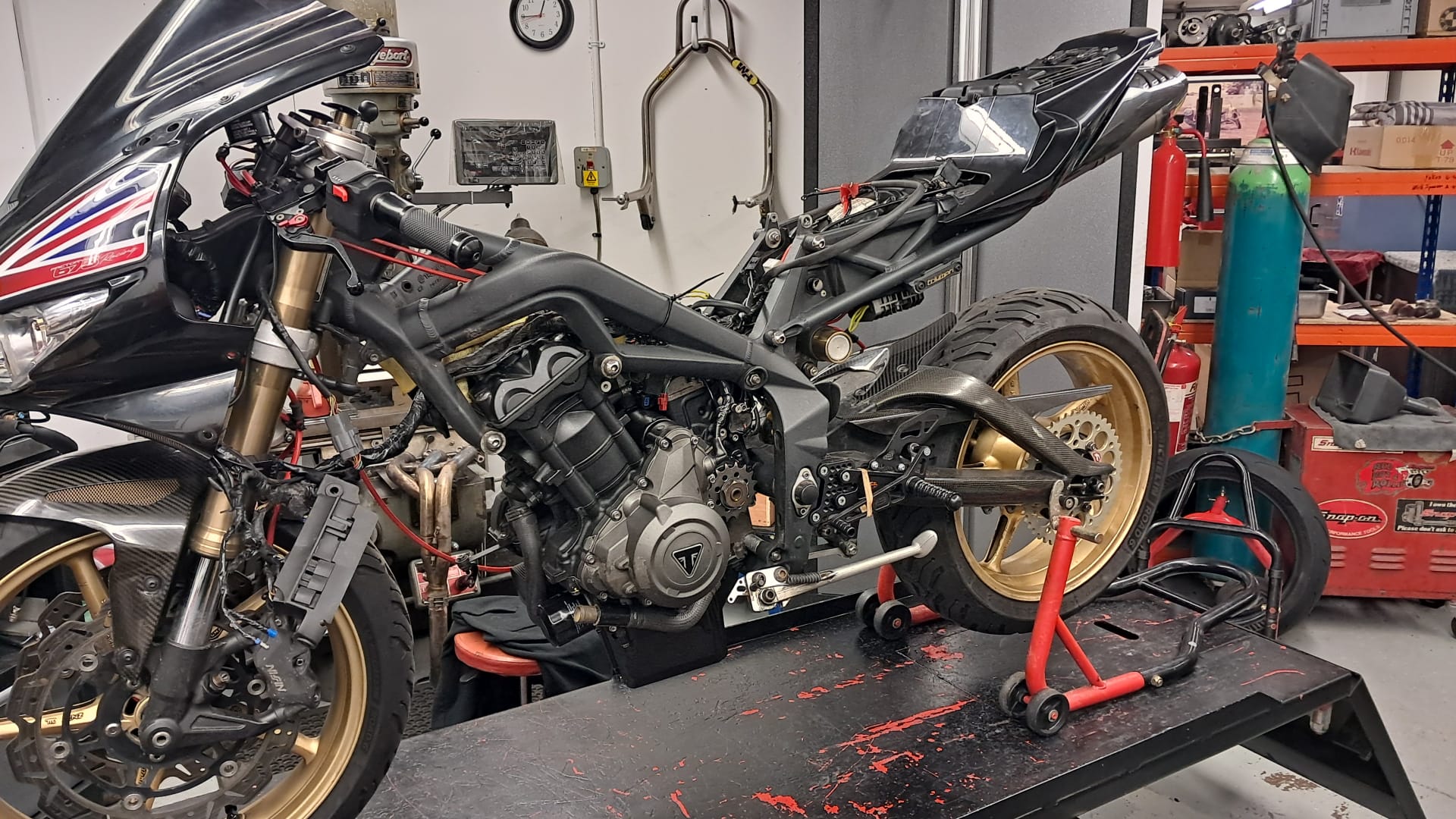

    A number of sensors have to be changed at this point, the speed sensor on the gen 2 isn't attached to the ABS system like on newer models, but luckily triumph left and blanked off where it sits on the 765 engine, uncover and plug the sensor from the 675 engine in, same goes for the gear position sensor from the gen 2, the ECU won't pick up or understand the 765 sensor but its a straight swap and means you just plug it back into the 675 harness

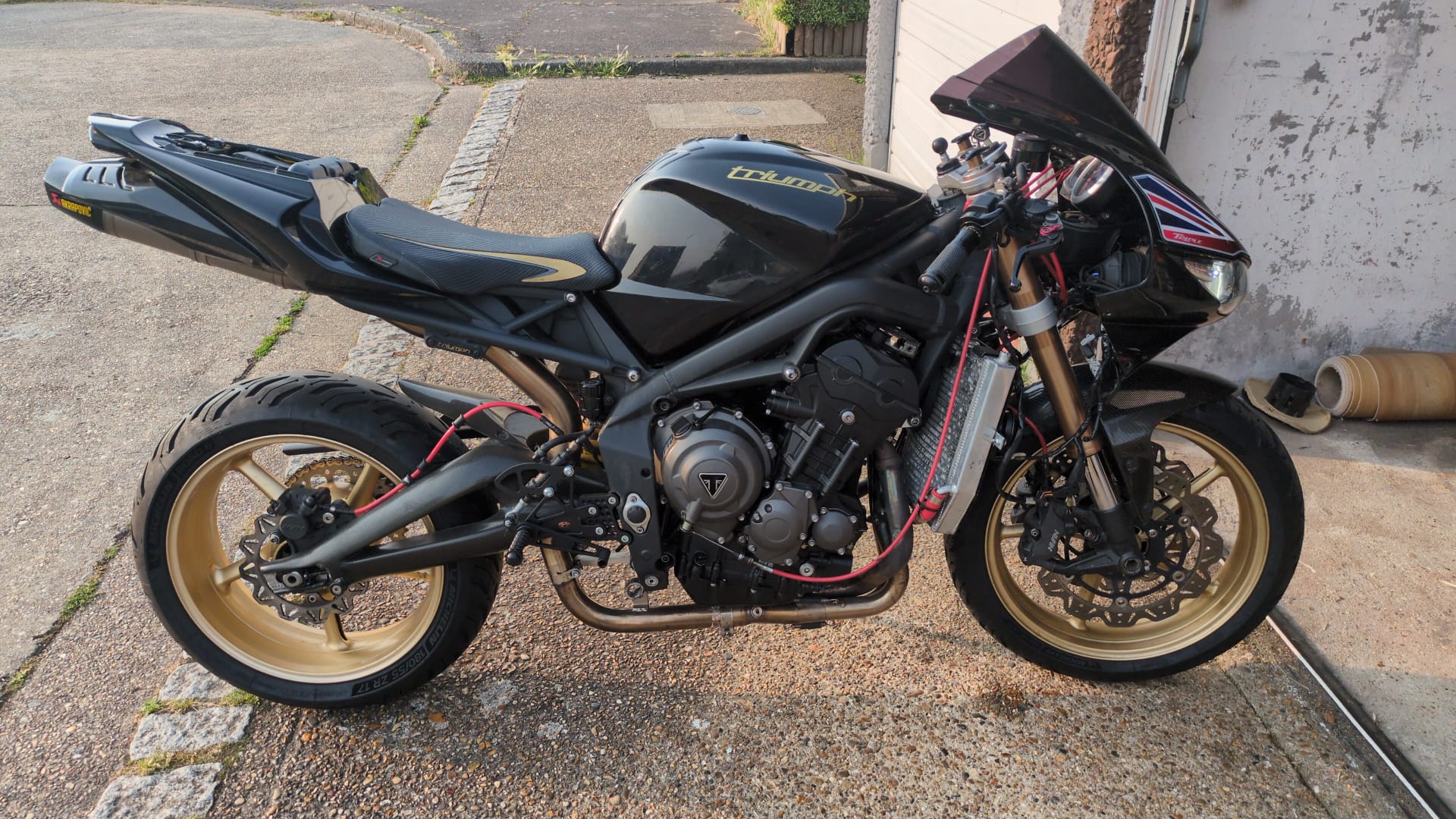

    This was the bike after getting it back so that I can start to test ride it and see if it has any other issues. The starting issue remains to a degree, and I noted that when rolling the throttle off the idle will drop to a point where it will stall, the lack of an idle screw means it doesn't stop, so I had to turn in the manual idle to create a new 'zero' point. This of course has thrown up the need to tweak the TPS sensor and stepper motor due to them reading differently to how they were set from the garage. The spec sheet says TPS voltage should read .60 give or take .02, mine reads .64 atm, the stepper motor reads .75 though when it goes through the motions. So that may not cause an issue but the mere fact I've adjusted the TPS by ways of a manual idle it will need to have the adaption reset so it can 'learn' what it needs to do at idle better.

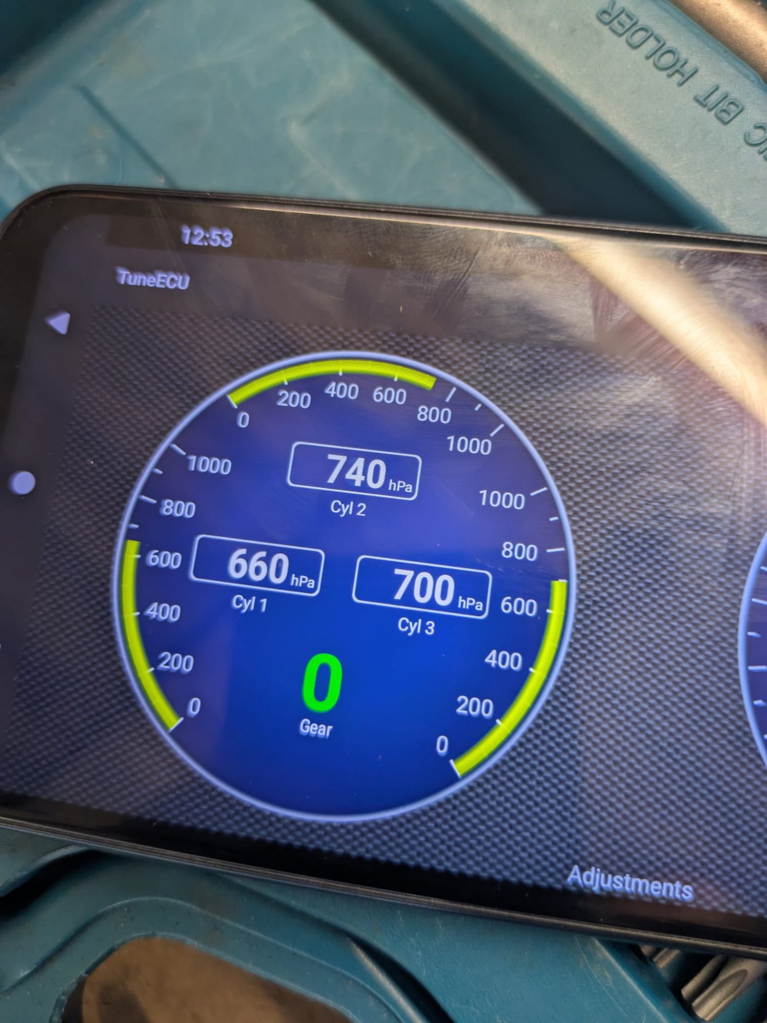

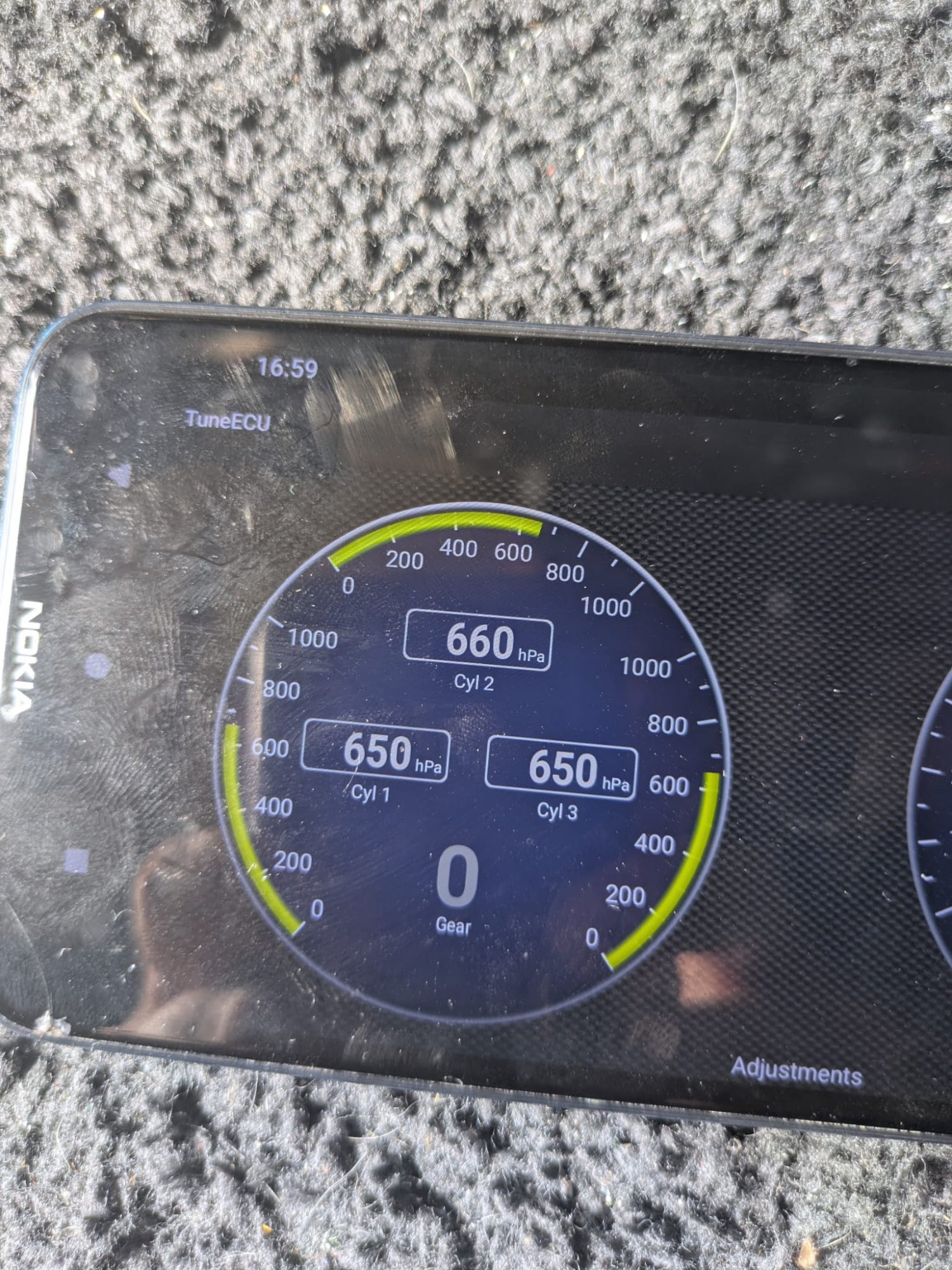

    I did notice with the bike running that the throttle bodies were out of balance by quite a bit as you can see.

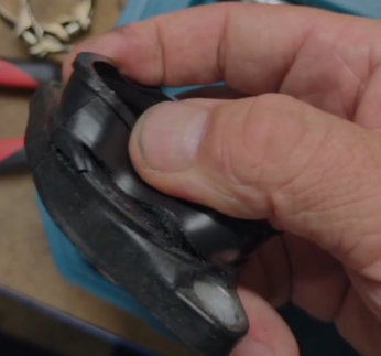

    While attempting to balance them I found that I could barely get them anywhere close to each other in the numbers. The end result was I took the throttle bodies off and inspected the rubber inlets they go into. What I found was two of them had splits in the rear and side, but hadn't gone through, the third however was showing quite a bad split all the way through, this of course would affect and make it impossible to balance.
    Replaced all three and was then able to get the throttle bodies to balance completely

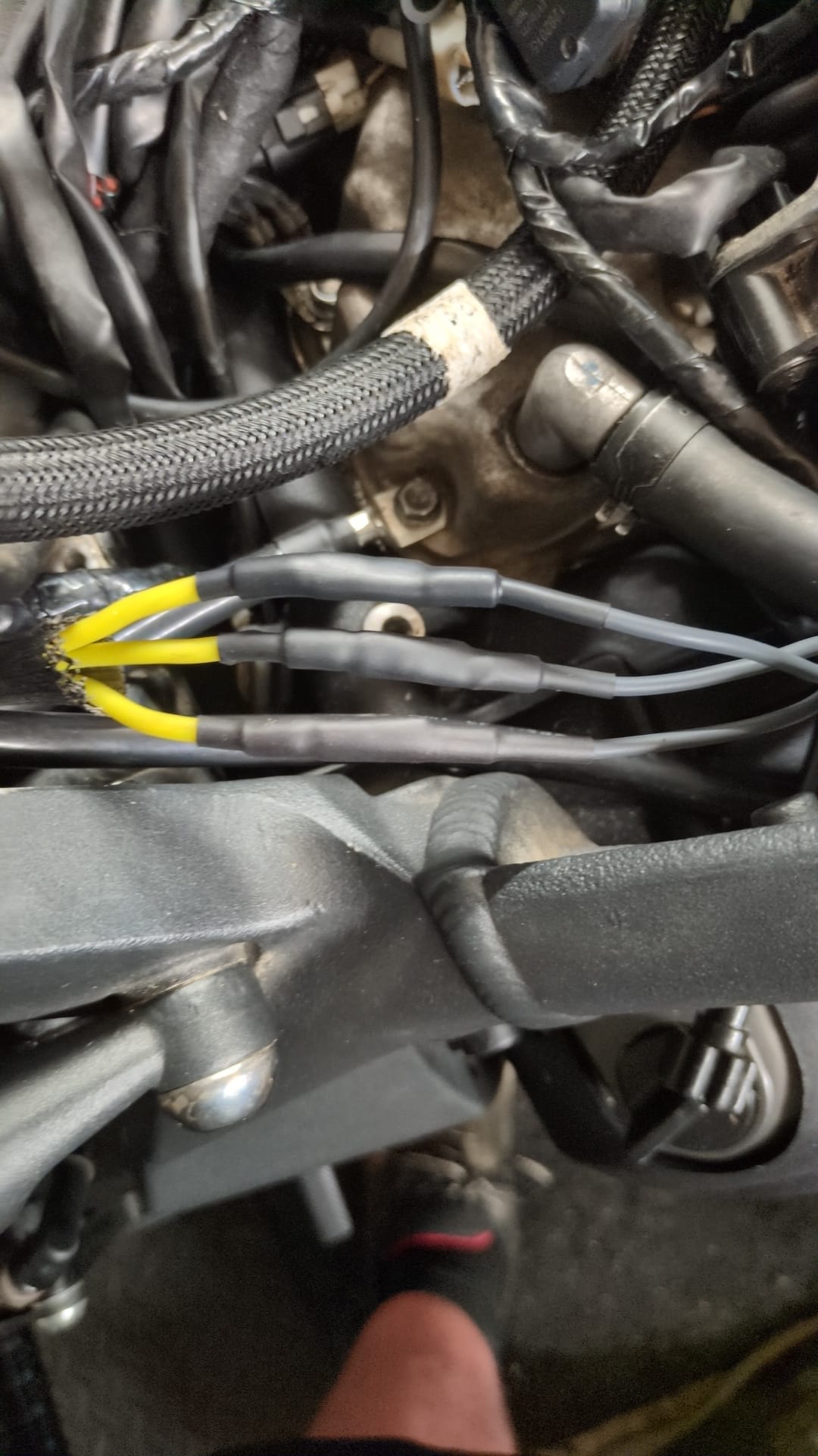

    This was then followed by the bike going back to cranking loads and not wanting to start again when hot, while cold not so much an issue but when warm/hot the bike will crank and not start. With the tank up I spotted the new plug that connects the stator to regulator direct had a wire coming out, out of the six wires going in, one of them was loose and would come up with minimal effort, I decided the best course of action would be to remove the plug and connect the wires directly using crimp connectors, followed by shrink wrap tubing to cover the join.
    WhatsApp Image 2025-07-12 at 15.54.23.jpeg WhatsApp Image 2025-07-12 at 15.50.19.jpeg
    I then tested the battery once I started the bike and it was reading 14.4 volts which is up from the below 14 it was showing before and even at one point dropping as low as 13.5, under load the battery showed no dips in voltage so I feel this issue has been corrected.

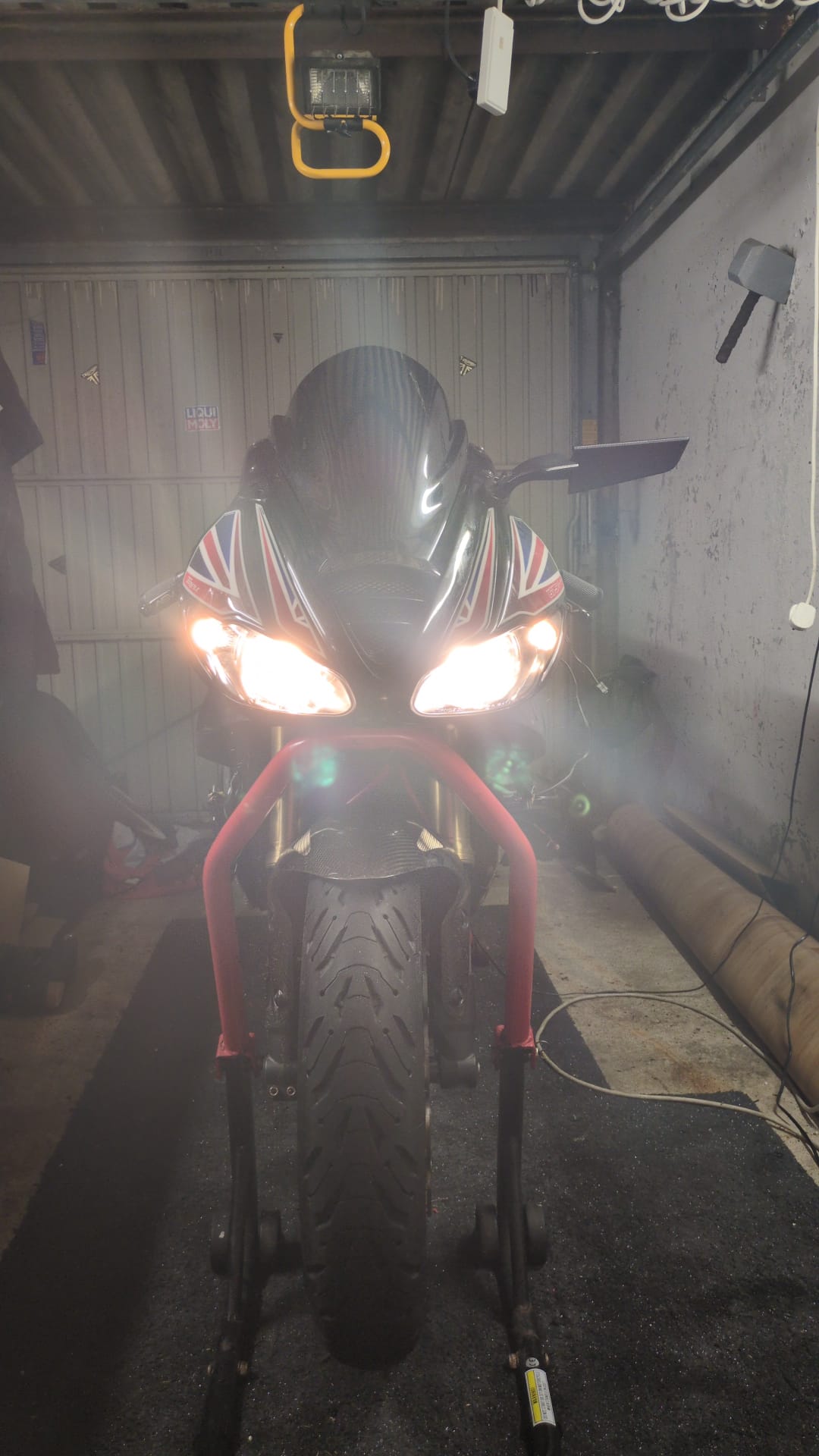

    Fitted the twinlight driver module and I have to say its not too bad. I still miss having the angel eye look but I'll look into those and all the wiring that goes with them over the winter. But here is what it looks like with it fitted and running.
    What I like about the twinlight driver is you can delay the start-up on the lights, I've got it set to 14 seconds from the moment I turn the key till they fire up, this can be over ridden by simply flashing the high beam button, but having them completely off means more power for the bike to start with, that's a bonus.

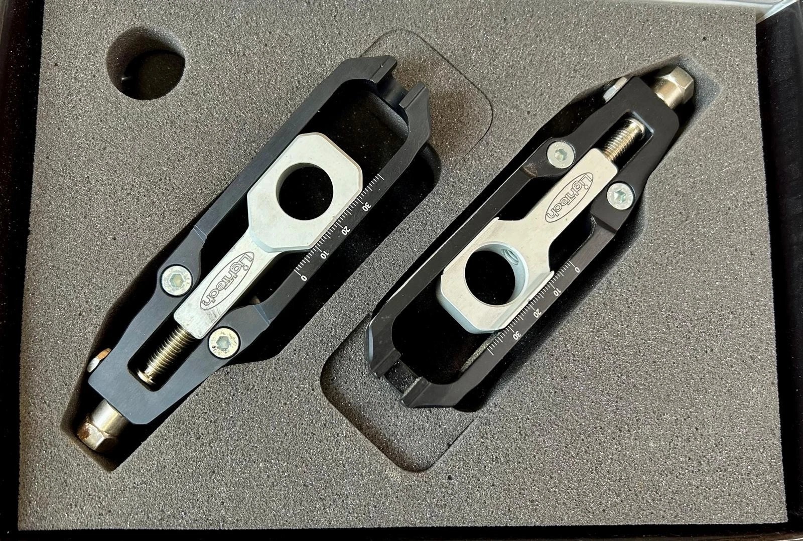

    As I said in my last post I did manage to get my hands on these too
    Not fitted them yet as they were sent off to be looked at in the hopes of making something similar, but I should be getting them back soon and will be fitted onto the bike. What I did do in the mean time was remove the gilles adjusters which was an absolute ball ache because for whatever reason they just wouldn't let the axle slide out smoothly, to the point once I did manage to hammer the axle out which damaged the threaded end, they wouldn't even let the axle go back through, so in the bin they went and for now I've gone back to the OEM adjusters.

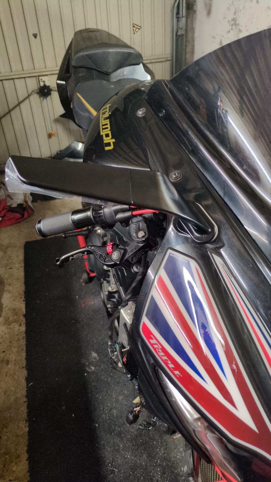

    And lastly I know these are a bit marmite for some, but stealth mirrors..... I got mine quite early on but they were never truly Rizoma ones and with the pivot point I hated they could be rotated or come loose which meant having to take the whole thing off just to tighten the bolt which was hidden under them. I've always thought one of the Rizoma ones for another bike would fit, so after various measuring and looking at the blueprints online I took a punt on some Aliexpress ones because I am not paying 400 quid for a gamble, these ones are for the 2018 BMW S1000RR
    And they fit, needs a bit of a push, longer thread rods because the ones they came with are too short, can I see anything more than the old ones, nope, so its a same same on that front but they are solid and have zero risk of coming loose.
